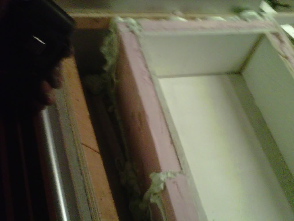

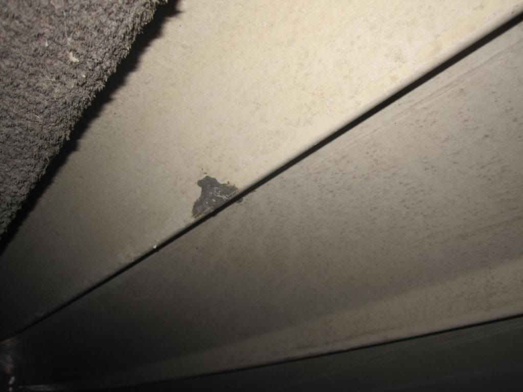

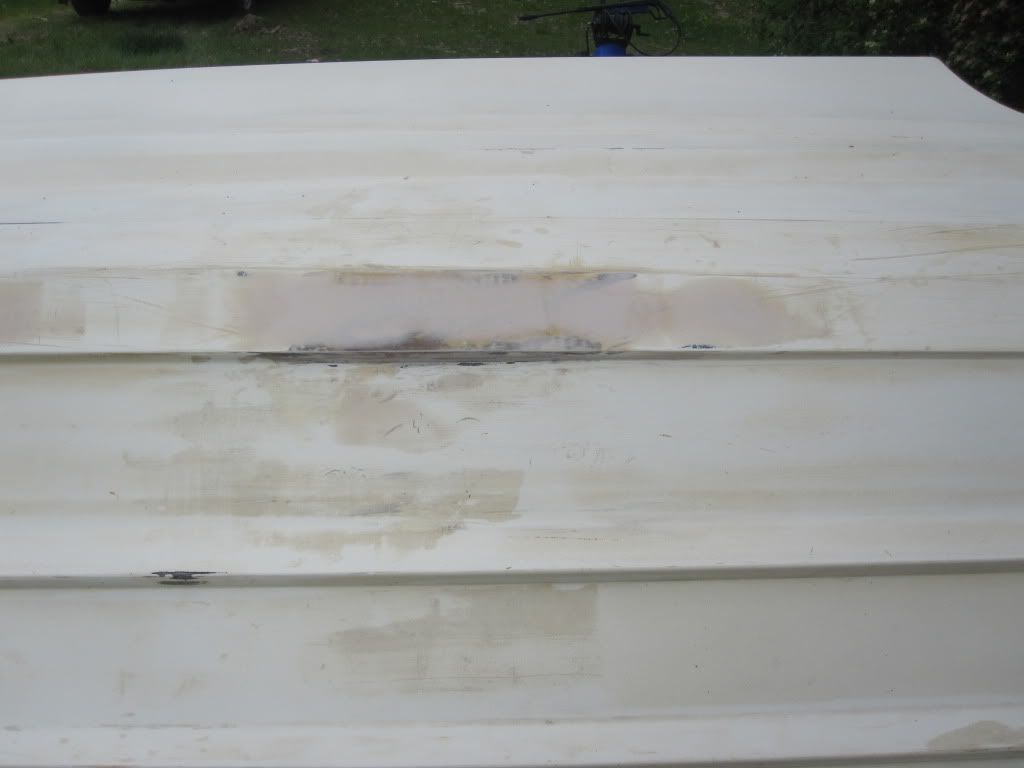

First job, thorough inspection of the hull, I found this:
And this:
And this:
And when that was not enough, I found this:

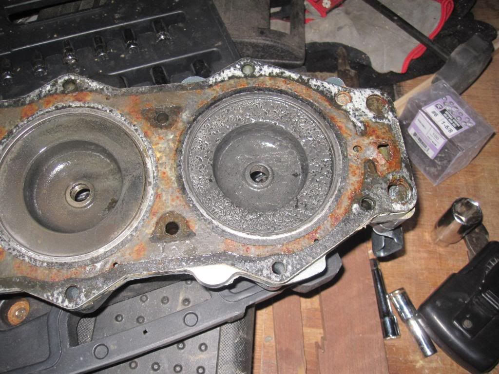

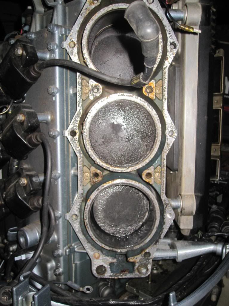

Ok, so I have some fibreglass work to do. On to the engine, which the seller assured me was fine. I expected to do some work to the hull, but the motor was OK. My brother came over and we fired it up, started no problem, and ran great, on FIVE out of the SIX cylinders. Pulled the heads and this is what I found:
The inside of the head:
The cylinder and piston:

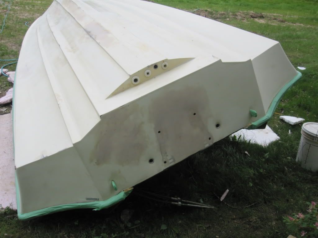

Then came the fibreglass repair, grind out the poor work, lay resin and roving, lay mat and resin, grind to shape, apply fairing compound, and sand, and sand, and sand, and sand, and sand, and sand, and sand, and when that is done, more sanding. I was using a 5” random orbit sander that is meant for finishing wood.
There is not one square inch of that hull that has not been rubbed by my hands at least four times.

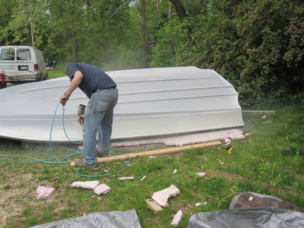

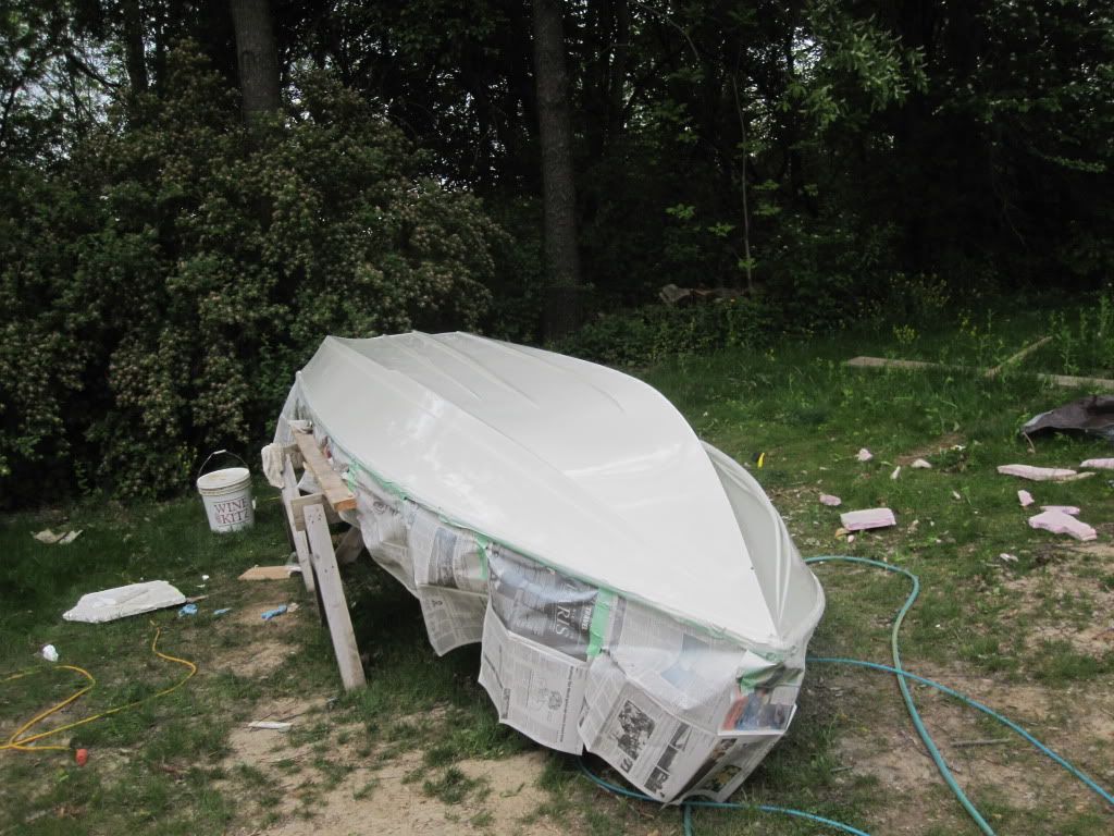

Well all of the sanding on the bottom of the hull was finally done, and I called my older brother to come by and spray it. He came by, and we had to sand, and sand, and sand, and sand, and sand, and sand, and sand, and sand, and sand, and sand, and sand, until it was up to his standards. I glad we did. However, twenty minutes after the paint flashed over, it %#$*&^@*&%$ rained! This caused a series of craters in the paint that was applied, so after it dried, I had to sand, and sand, and sand, and sand, and sand, and sand, and sand, and sand, and sand, and sand, and sand, and sand, and sand, and sand, and sand, and sand, in order to get the hull ready again. Once again, he came over and sprayed the hull.
Finished:
The weather cooperated, the paint cured for four days, six guys came over and we flipped the hull right side up. With incredible care! Now, to get it in the trailer…..The bow eye having been reinstalled, and tightened very well……OH THE TRAILER!

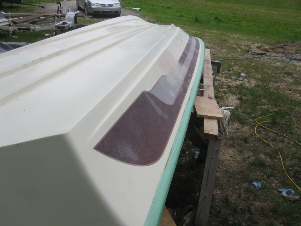

Well, now I have a nice hull, but a unpleasant top cap, so guess what needs to be done to the top cap? You guessed it I had to sand, and sand, and sand, and sand, and sand, and sand, and sand, and sand, and sand, and sand, and sand, and sand, and sand, and sand, and sand, and sand, and sand, and sand, and sand, and sand, and sand, and sand, and sand, and sand, and sand, and sand, and sand, and sand, and sand, and sand, and sand, and sand, and sand, and the sand some more! There was more sanding and fairing involved with the top cap than with the hull.
Off to the paint shop, (no rain on this one), three coats of primer, HAND sanded between coats, and it was ready for paint. I gave my brother complete freedom in the paint and striping details so I was not around to tell that story, however I heard it involved a 3 am finish time…..
